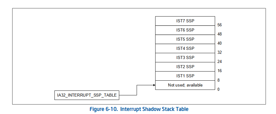

x86_64 also has a feature which is not available on i386, the ability to
automatically switch to a new stack for designated events such as double fault
or NMI, which makes it easier to handle these unusual events on x86_64. This
feature is called the Interrupt Stack Table (IST). There can be up to 7 IST
entries per CPU. The IST code is an index into the Task State Segment (TSS). The
IST entries in the TSS point to dedicated stacks
; each stack can be a different
size.
An IST is selected by a non-zero value in the IST field of an interrupt-gate
descriptor. When an interrupt occurs and the hardware loads such a descriptor,
the hardware automatically sets the new stack pointer based on the IST value,
then invokes the interrupt handler
[1]

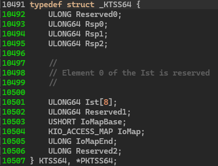

Как это устроено в Windows? Судя по описанию, таблица IST находится в TSS. Точнее в структуре _KTSS64.
kd> dx -id 0,0,fffff8050cd48f40 -r1 ((ntkrnlmp!_KTSS64 *)0xfffff8050f9e7000)
((ntkrnlmp!_KTSS64 *)0xfffff8050f9e7000)                 : 0xfffff8050f9e7000 [Type: _KTSS64 *]
    [+0x000] Reserved0        : 0x0 [Type: unsigned long]
    [+0x004] Rsp0             : 0xfffff8050f9ea200 [Type: unsigned __int64]
    [+0x00c] Rsp1             : 0x0 [Type: unsigned __int64]
    [+0x014] Rsp2             : 0x0 [Type: unsigned __int64]
    [+0x01c] Ist              [Type: unsigned __int64 [8]]
    [+0x05c] Reserved1        : 0x0 [Type: unsigned __int64]
    [+0x064] Reserved2        : 0x0 [Type: unsigned short]
    [+0x066] IoMapBase        : 0x68 [Type: unsigned short]

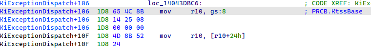

P.P.S. Нашел обращение к KtssBase в KiExceptionDispatch.
Странно, ибо искал по этому паттерну и получил бублик.
