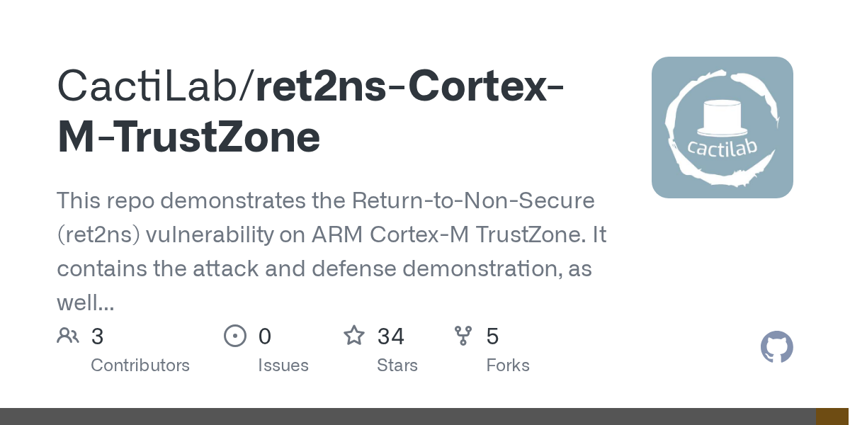

After studying your question in more depth, I realized that you need to focus not on the exploitation technique return-to-user (ret2usr), but on its analogue, which was, by the way, based on the same principle.
We are talking about the so-called exploitation technique Return-to-Non-Secure (ret2ns).
paper "Return-to-Non-Secure Vulnerabilities on ARM Cortex-M TrustZone: Attack and Defense"
git repository

exactly !! this was the research paper i was looking at so basically what i am trying to figure out is if this attack can be applied in theory this attack on the TF-A so at the moment what i am trying to figure out is where the secure services are in https://github.com/ARM-software/arm-trusted-firmware so that i potentially write a secure service my self and try to fuzz around and understand how the API is communicating, now for the SCR yes its really important as i searched it contains the control bit and the NS bit which makes it priv or non priv and sec world or not but the attack of ret2user was stack overflow to corrupt the blxns pointer location
my question is where are the secure services and where is the SMC handler so i can understand how can we potentially fuzz around and if it uses the bx , blxns instruction or not
